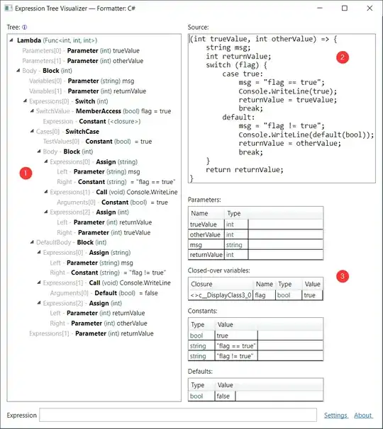

(Disclaimer: I am the author of the visualizer in question.)
I've written a debugging visualizer for Visual Studio:
- 13,950
- 6
- 64
- 136
Hi, I am trying to use the extension in VS 2019, but I'm getting the following error: `Could not load file or assembly 'System.Runtime, Version=4.2.0.0, Culture=neutral, PublicKeyToken=b03f5f7f11d50a3a' or one of its dependencies.`. Any idea of what could be? Thanks – Ender Look Feb 06 '20 at 19:08
@EnderLook Can we continue this in a [GitHub issue](https://github.com/zspitz/ExpressionTreeVisualizer/issues)? Which version of the extension are you using? If you're not using the most recent release, then try that first. Also, what runtime is your project targeting? Also, if you could get a string representation of your expression -- using [ExpressionTreeToString](https://github.com/zspitz/ExpressionTreeToString) -- that would also be helpful. Also, you may need to unblock the ZIP file, or even the individual files. – Zev Spitz Feb 06 '20 at 23:56
Done https://github.com/zspitz/ExpressionTreeVisualizer/issues/103. I didn't attach a string representation of my expression because I get the problem with all expressions. Didn't understand what you mean with unblock the ZIP file, you mean unzip?. Thanks – Ender Look Feb 07 '20 at 00:28
RE unblocking, see [here](https://github.com/zspitz/ExpressionTreeVisualizer/wiki/Troubleshooting-visualizer-installation). – Zev Spitz Feb 07 '20 at 01:13
