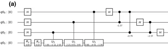

To search for that, the authors proposed following cicuit Circuit in article
Note that gates denoted by -1.57 and -0.79 are $S^\dagger$ and $T^\dagger$ respecitvelly. They act on "bottom" qubit and they are controlled by "top" qubit
$U3$ operators implement operator $\mathrm{e}^{2\pi i \rho}$ and its powers.

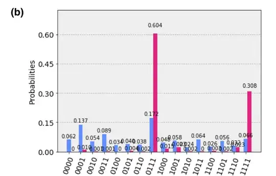

According to the article, results after measurement should be these:
Article result
Note that pink bars are results obtained on simulator, while blue ones on IBMQX2 processor.
Based on these results, the authors concluded that the largest eigenvalue is approximated by value $0.111_2$ (0.875 in decimal which is close to actual value 0.8576).

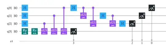

I tried to replicate their results with this circuit on IBM Q:
My circuit
Note: please find a code in QASM at the end of the question to see parameters of gates

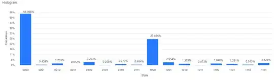

I received these results on IBM Q simulator.
My results
According to my results, the largest eigenvalue should be zero which does not make sense.
So, my questions are these:
  1. Where I did a mistake in circuit implementation? My circuit and the author's seems to be the same.
  2. Why the qubit $|q_3\rangle$ is initialized by gates $Ry$ and $Rz$ with parameter $\theta$ equal to 1.00 and 0.33, respectively? I would expect only gate $Ry$ with $\theta = 1.1665$ as this gate produce the eigenvector $(0.8347; 0.5508)^T$. However, replacement of $Ry(1.00)$ and $Rz(0.33)$ with $Ry(1.1665)$ does not change resulting histogram significantly.
Here is a QASM code of my circuit

One thing that I noticed. If cu3 gate from $q[2]$ to $q[0]$ is some $U$, then the cu3 from $q[2]$ to $q[0]$ should be $U^2$ in the phase estimation algorithm, but the comparisons of operators with the help of numpy.array showed me that it's not true here. I tried to implement by replacing cu3 part of the QASM code with the following:
cu3(1.6, -1.12, 2.03) q[2] q[3]
cu3(1.6, -1.12, 2.03) q[1] q[3]
cu3(1.6, -1.12, 2.03) q[0] q[3]
And obtained a different result via IBM's 'qasm simulator':
{'0010': 39, '0101': 13, '1110': 16, '0110': 47, '1011': 4, '1010': 8, '1000': 92, '1101': 5, '1111': 143, '1001': 22, '0011': 10, '0001': 16, '1100': 3, '0100': 8, '0000': 235, '0111': 363}
And the sum of '1111' and '0111' outcomes is maximum (here 506 from 1024 measurements) as was obtained in the paper.
