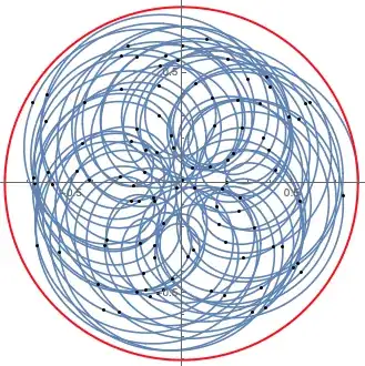

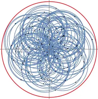

Note also that the normalisation of $\ket\mu$ implies $$ \sqoverlap\mu\lambda + \sum_k |\langle\mu|\lambda_k\rangle|^2 = 1 $$ The problem here is clearly in how to handle $F_r\in\mathbb C$, which has a pretty nasty behaviour: as a function of $r$, it oscillates wildly in the complex plane. Without any constraint on the possible $\ket{\lambda_k}$ and $\varphi_k$, or on the total dimension of $U$, pretty much any shape is possible (and here I cannot not link this beautiful video by 3Blue1Brown). Just to give a mental picture of what I mean, here are two examples of what you can get when you plot $r\mapsto F_r$ for randomly sampled phases and overlaps, for a six-dimensional $U$:
The black dots correspond to the integer values of $r$, the blue line gives the value of $F_r$ for the real values in-between, and the red circle has radius $1-\sqoverlap{\mu}{\lambda}$. Only values of $r$ between $1$ and $100$ are shown.

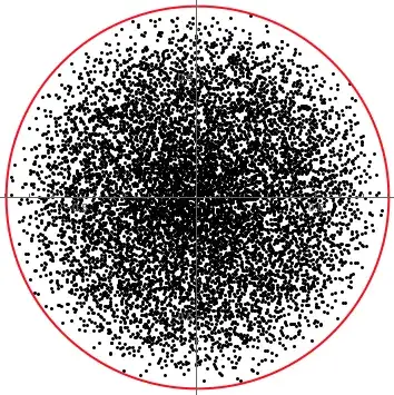

Plotting even more points (all $r$ between $1$ and $10^3$), we see that the circle is essentially filled:
This is telling us that, in the general case, all we can say about $F_r$ is that it satisfies $$ |F_r|\le1-\sqoverlap\mu\lambda. $$ Now, to get the probability of finding the initial state $\ket\mu$ unchanged after $r$ applications of $U$, we need to study the quantity $|\langle\mu|U^r|\mu\rangle|=\big|\sqoverlap\mu\lambda+F_r\big|$. When $\sqoverlap\mu\lambda\ge1/2$ we know that $|F_r|\le\sqoverlap\mu\lambda$, and we thus have the bound $$ (2\sqoverlap{\mu}{\lambda}-1)^2 \le |\langle\mu|U^r|\mu\rangle|^2 \le 1,\quad \forall r. $$ On the other hand, when the initial squared overlap is smaller than $1/2$, we can have $F_r=-\sqoverlap\mu\lambda$, and thus we get the trivial bound $|\langle\mu|U^r|\mu\rangle|\in[0,1]$.

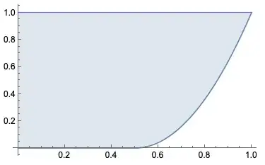

Putting the two cases together, if we plot the possible values of $|\langle\mu|U^r|\mu\rangle|^2$ as a function of $p\equiv\sqoverlap\mu\lambda$ we get the following:
The interesting conclusion is that we can say something about the possible probabilities of a state remaining unchanged after a number of applications of the same unitary $U$, provided that the initial overlap between the state and one of the eigenvectors of $U$ is big enough. Let me remark a few other things here:
  • There is no loss of generality in our initial assumption that the eigenvalue of some $\ket\lambda$ is $1$. We can repeat the same identical argument by just taking an arbitrary eigenvector of $U$ with eigenvalue $e^{i\varphi}$, by only replacing each instance of $U$ with $U e^{-i\varphi}$. Most notably, this does not affect the final result on $|\langle\mu|U^r|\mu\rangle|$.
  • If $\sqoverlap\mu\lambda=1-\delta$ with $\delta\ge0$ small, then the bound can be simplified to $|\langle\mu|U^r|\mu\rangle|^2\ge 1-4\delta$.
  • Because we are not putting any constraint on $U$ or $r$ other than the initial overlap $\sqoverlap\mu\lambda$, we can also understand this result as telling us about the probability of $\ket\mu$ being unchanged upon a single application of a unitary $U$, or more generally about the probability of $\ket\mu$ being unchanged upon arbitrary applications of arbitrary unitaries all having an eigenvector close enough to $\ket\mu$.
