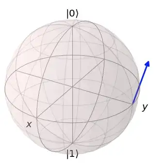

new_arrow = qutip.bloch.Arrow3D(xs=[1, 1], ys=[0, .5], zs=[0, .5],
                    mutation_scale=b.vector_mutation,
                    lw=b.vector_width, arrowstyle=b.vector_style, color='blue')
b.axes.add_artist(new_arrow)
which gives
note that we need to call explicitly b.render instead of b.show because we need the axes object to be created but the plot to not be drawn before we add the new arrow.
Just change the coordinates given to the parameters xs, ys, zs to decide what vectors to draw.
