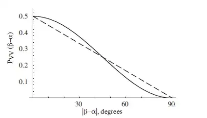

Another way to look at it is to say that the string r as a shared randomness is referred to as a hidden variabele in physics. So the Hidden Variabele Theory is equivalent to using a string r in a turing machine. Therefore we might just as well make use of a proof of the CHSH inequality. Furthermore we can compare an arbitrary HVT (dashed line ) and QM results for a photonic experiment. enter image description here
A compact proof of the CHSH inequality based on a hidden variabele can be found in the article Entangled photons, nonlocality and Bell inequalities in the undergraduate laboratory.
