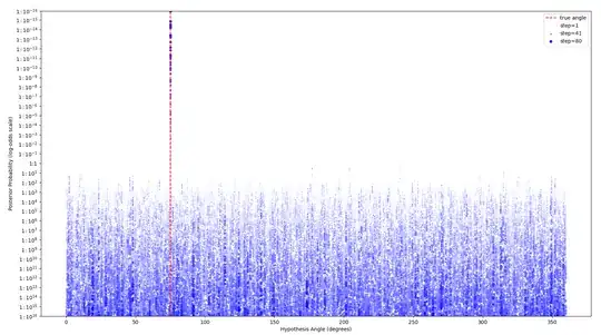

Suppose that instead of picking $\phi$ and $m$ in a structured way, they were simply chosen at random for each step. In the small numerical tests I've done (code at bottom of question) this still converges exponentially quickly towards $\theta$. If you feed the randomly chosen parameters and outputs from each step into a naive Bayesian inference, it quickly picks out the true $\theta$ from the other hypothesis angles:
So great, it works... except naive Bayesian inference requires space proportional to the number of candidate hypotheses. In real algorithms that could easily be $2^{1000}$ different hypothesis angles. The inference needs to be done in a more clever way for a classical control system to actually recover in the angle in practice, if the parameters are being chosen randomly.
