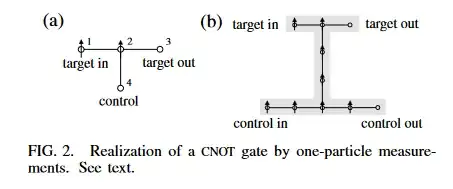

However, I am having trouble on how these by-product operators come about, and the teleportation of the state, when we move to 2D clusters. In general, I cannot find concrete sources or examples of how 2 qubit gates are actually implemented, and why it works, An example I am looking at, but having issue with, is the following representation of a CNOT gate on a 4 qubit cluster:
CNOT on cluster state
Specifically figure 2.(a) in A One-Way Quantum Computer. They state that the end state should be $$|s_{1}\rangle_{x,1}\otimes|s_{2}\rangle_{x,2}\otimes U_{\Sigma}^{34}(|i_{4}\rangle_{z,4}\otimes|(i_{1}+i_{4}) mod 2\rangle_{z,3})$$ with $$U_{\Sigma}^{34}=\sigma_{z}^{3^{s1+1}}\sigma_{x}^{3^{s2}}\sigma_{z}^{4^{s1}}$$
Now maybe I have missed something obvious in the literature, but it's not clear to me how they are arriving at this. Given a starting state of, for example, $$|0\rangle_{z,1}\otimes|1\rangle_{z,4}\otimes|+\rangle_{x,2}\otimes|+\rangle_{x,3}\,,$$ after performing the $CZ$ operations between 1 and 2, 2 and 3 and 2 and 4, and measuring 1 and 2, after measuring the readout, ie 3 and 4, and reordering them gives $$|-\rangle_{x,1}\otimes|-\rangle_{x,2}\otimes|0\rangle_{x,3}\otimes |1\rangle_{z,4}$$ with
$$U_{\Sigma}^{34}=\sigma_{x}^{3}\sigma_{z}^{4}$$
which means, discounting $U_{\Sigma}^{34}$, I have $|-\rangle_{x,1}\otimes|-\rangle_{x,2}\otimes|1\rangle_{x,3}\otimes |1\rangle_{z,4}$, which is the desired outcome of flipping qubit 1 based on qubit 4 being $|1 \rangle$.
What I would like to understand is how the byproduct operators emerge as a result of the measurements., ie where Z and H emerge from. I feel like most of the literature on MBQC really does ignore higher dimensional clusters despite their importance w.r.t examples, with few solid ones of how 2d is meant to work. Most of it focuses on eigenvalue and stabilizer formalism, but as I havent't work with computations in this manner, I am unsure how it progresses.
Edit: Taking a look at Measurement-based quantum computation with cluster states, the general method is to update the eigenvalue equations or the stabilizers with commuting stabilisers given the measurements. But what is not clear to me is how we can take the starting set of stabilizers for the cluster state, and get the end by-product operations from them. These are the starting stabilizers, but the usual process of taking the anti-commuting ones and taking their product, and introducing the new stabilizer doesn't work here, as we have measurement results. Additionally, it isn't clear how the bi-product operators emerge from this.
$$\{ \sigma_{x}^{1}\sigma_{z}^{2},\sigma_{x}^{4}\sigma_{z}^{2},\sigma_{x}^{3}\sigma_{z}^{2},\sigma_{x}^{2}\sigma_{z}^{1}\sigma_{z}^{3}\sigma_{z}^{4} \}$$ Th

It's going to depend heavily on how the 2d structure is arranged, but my main way of understanding these situations is, think of the 1D wires as qubits which flow down the wire and the CZ connecting different wires, simply as a CZ between the qubits on those wires.
In Fig A, lets say we start with the initial state $|\psi\rangle |\phi\rangle$ (no reason it is not already entangled). We measure the first qubit such that the angle is 0, so after the measurement (up to some paulis and adaptive measurements) $(H\otimes I)|\psi\rangle |\phi\rangle$. We then perform a $CZ$ between the two wires and have $CZ(H\otimes I)|\psi\rangle |\phi\rangle $. Finally we perform another measurement on the top qubit so have $(H\otimes I)CZ(H\otimes I)|\psi\rangle |\phi\rangle = CX_{2,1} |\psi\rangle |\phi \rangle$ as required.
