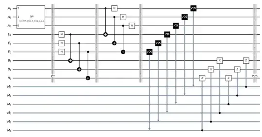

As mentioned in the link shared the the OP, a simple way to extend the teleportation protocol to $n$ qubits is to basically replicate the teleportation procedure for each of the qubits. This works even if the state to be teleported is entangled.
However, for sake of clarity, I am posting a separate answer here since the example given in the original post is specifically for 2 qubits, uses deferred measurements, and shows the answer in terms of measured probabilities, which is not a guarantee that the state was teleported with the correct phases.
The Qiskit code below works for an arbitrary number of $n$ qubits. The only adjustment needed is to make sure the list used to define the state ψ is of size $2^n$ and represents the normalized probability amplitudes of a valid statevector.

This code produces the following circuit to teleport 3 qubits: enter image description here
and generates the following output, which shows that the state Bob receives matches the state Alice prepared:
State prepared by Alice:
$ \frac{\sqrt{6}}{6} |001\rangle+\frac{\sqrt{3}}{3} |010\rangle+\frac{\sqrt{2}}{2} |100\rangle $
State received by Bob:
