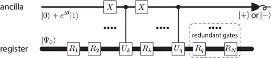

From this we can get the time derivative of the parameters by calculating the A-matrix and C-vector. The elements of these can be measured by quantum circuits, like this one for the elements of the A matrix:
Quantum circuit for the evaluation of coefficients in the variational pure-state simulator

To understand how their code works, I looked at the VarQITE class and tried to understand how the evolve( ) function works. But I dont find the circuits for determining the A-matrix and C-vector elements anywhere. Are they doing it differently? If yes does anyone understand how Qiskit is doing it.

The class ImaginaryMcLachlanPrinciple uses LinCombEstimatorGradient ( LinCombQGT ) by default to evaluates the vector (matrix) elements of $C_i$ ($A_{ij}$) with a circuit similar to the one you mentioned. You can look in these classes to find the exact implementation. documentation
I am also implementing VarQITE from scratch and I cannot help you much more as I also have difficulties with my implementation. I hope this helps you to navigate the code to answer your questions.
