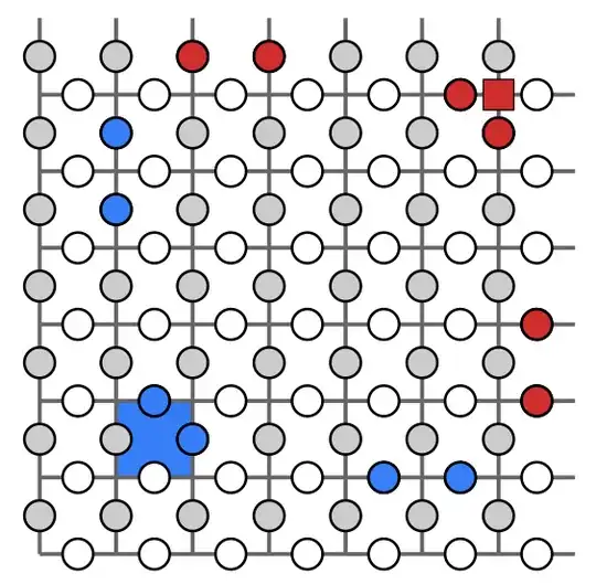

Bivariate bicycle codes (BB codes) can be thought of as codes where the physical qubits sit on the edges of a 2D lattice. The integers $l$ and $m$ are the horizontal and vertical size of the lattice.
Inspired by the toric code, let's use the convention that each plaquette is a $Z$ type stabiliser and each vertex is an $X$ type stabiliser.
For example, for $l = m = 7$ it could look like this (because I just took a screenshot there are already some stabilisers in there, let's concentrate on the lattice as such):
picture of the lattice with some stabs
Like this, we immediately verify that there are $l \cdot m$ $X$ type stabilisers, $l \cdot m$ $Z$ type stabilisers as well as $2\cdot l\cdot m$ physical qubits.
In fact, these physical qubits can be split into two ''sub-lattices'' of horizontal (white) and vertical (grey) qubits (qubits sitting on horizontal edges resp. vertical edges). Both of course have size $l\cdot m$ each.

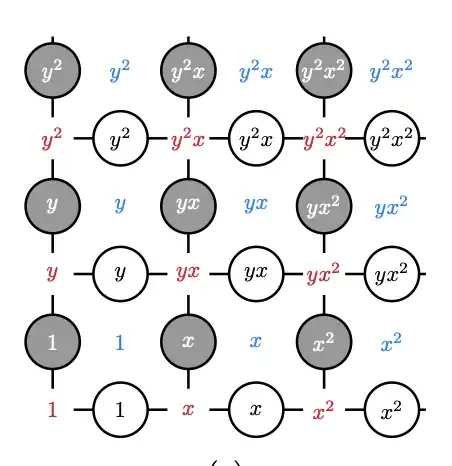

Now, we can do something nice. We can label in each of the two sub-lattices the qubits, as well as each the $X$-type and the $Z$-type stabilisers, with monomials from $\mathbb{F}_2[x,y]/(x^l -1, y^m - 1)$ like this (in a smaller lattice now):
labelling of qubits and stabilizers
So basically the $x$-degree of the monomial tells you how far right you are, the $y$-degree how high up. The fact that we calculate modulo $(x^l -1, y^m - 1)$ nicely reflects that we have periodic boundary conditions here: If you are ''at the top'' (at height $m-1$) and go one step up, you come out at hight 0.

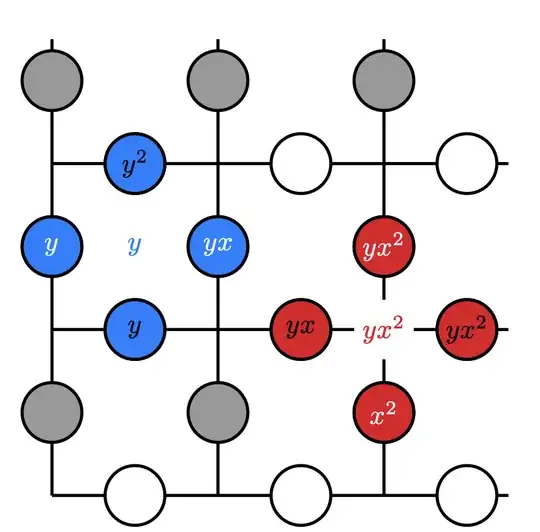

Then we can define our stabilisers such that
  • the $Z$-type stabiliser labelled by a monomial $p$ checks all vertical qubits that appear as monomial terms in $A(x,y)p$ and all horizontal qubits that appear as monomial terms in $B(x,y)p$,
  • and the $X$-type stabiliser labelled by a monomial $p$ checks all horizontal qubits that appear as monomial terms in $A(x^{-1},y^{-1})p$ and all vertical qubits that appear as monomial terms in $B(x^{-1},y^{-1})p$.
Note how we ''flipped everything'' going from $Z$ type stabilisers to $X$ type stabilisers: We exchanged ''horizontal'' with ''vertical'' and by using $A(x^{-1},y^{-1})$ instead of $A(x,y)$ resp. $B(x^{-1},y^{-1})$ instead of $B(x,y)$, we changed from going right with $x$ and up with $y$ to going left with $x$ and down with $y$.
So for the toric code, so $A(x,y) = 1 + x$ and $B(x,y) = 1 + y$, that looks like this:
As an exercise, one can label the qubits and checks in the first screenshot above and figure out what $A(x,y)$ and $B(x,y)$ are here, a solution to the exercise is in the caption of Figure 1 in 3 :)
