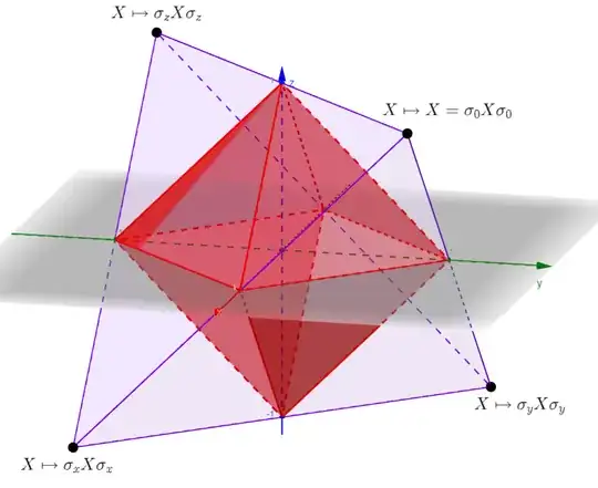

This lets us visualize things as follows:
Entanglement-breaking channels inside the Fujiwara-Algoet tetrahedron
The purple tetrahedron is the set of all Pauli-diagonal channels, and the red diamond sitting inside is the set of all entanglement-breaking Pauli-diagonal channels. Note how the corners of the purple tetrahedron are precisely the Pauli channels (unitary!). This geometric insight will be the key to proving the following:

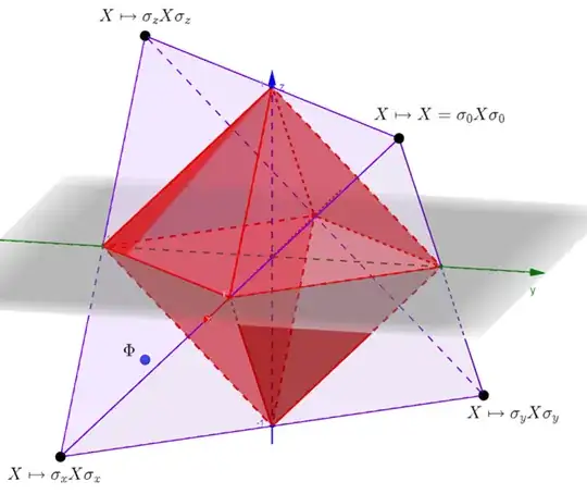

  2. $\Phi$ does not lie in the red diamond. Choose the corner of the Fujiwara-Algoet tetrahedron that $\Phi$ is closest to; in this example image this would be the X-corner $(1,-1,-1)$:
Example channel in the Fujiwara-Algoet tetrahedron

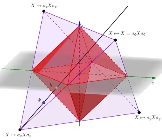

Then draw the ray from this corner through $\Phi$; by construction it will intersect the red diamond in some point $b$:
Ray from X through Phi to find b
In particular, because $\Phi$ lies between the corner $c$ in question and $b$ there exists $p\in[0,1]$ such that $\Phi=pb+(1-p)c$. But this point $b$ corresponds to an entanglement-breaking Pauli-diagonal channel $B$ meaning the decomposition we found is equivalent to $$ {\rm Ad}_{U_1^\dagger}\circ T\circ {\rm Ad}_{U_2^\dagger}=pB+(1-p){\rm Ad}_{\sigma_c}\,. $$ Getting $U_1,U_2$ to the other side yields the desired decomposition $$ T=p{\rm Ad}_{U_1}\circ B\circ {\rm Ad}_{U_2}+(1-p){\rm Ad}_{U_1}\circ{\rm Ad}_{\sigma_c}\circ {\rm Ad}_{U_2}\,.\tag*{$\square$} $$
