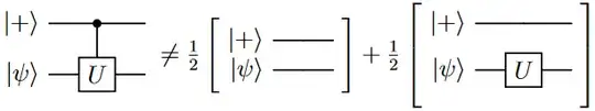

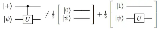

Given a quantum circuit with 2 qubits that executes a controlled gate $CU$ where the control qubit is in the $\ket{+}$ state, and the target qubit is in an arbitrary state $\ket{\psi}$.
Intuitively, I would assume that this circuit can be decomposed into two circuits, one with initial state $\ket{0}\ket{\psi}$ that doesn't execute $U$ on the target qubit, and one with initial state $\ket{1}\otimes\ket{\psi}$ that executes $U$ on the target qubit. The idea is that the control qubit, when measured, will be 0 in 50% of the shots ($U$ is not executed) and 1 in the other 50% of the shots ($U$ is executed).
However, from doing the math, I came to the conclusion that this doesn't work:
Leaving the initial state as $\ket{+}\otimes\ket{\psi}$ does not work either:
I assume the phase kickback is the problem here.
Is there a way to to decompose the $CU$ gate into 1-qubit operations when the control qubit is in state $\ket{+}$?
My calculations:

We have, $$|+\rangle = \frac{1}{\sqrt{2}} |0\rangle + \frac{1}{\sqrt{2}} |1\rangle$$ So, you should replace $\frac{1}{2}$ by $\frac{1}{\sqrt{2}}$ here: enter image description here
