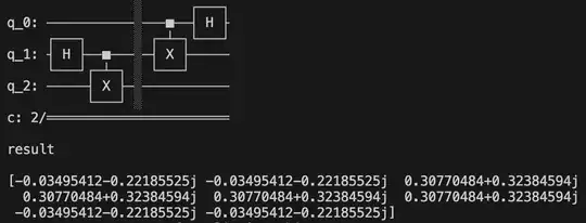

And then, by using a standard quantum teleportation circuit, I proceed with quantum teleportation.
#qc is stage1. generate Bell state and operate in Alice's side
qc = QuantumCircuit(3, 2,global_phase=0)
# Prepare an entangled Bell pair between Alice and Bob
qc.h(1)
qc.cx(1, 2)
qc.barrier()
# Entangle the state to be teleported with Alice's qubit
qc.cx(0, 1)
qc.h(0)
#evolve compound statevector through evolve method. compound_statevector = compound_statevector.evolve(qc) print(qc) print("result\n") print(compound_statevector.data)
Then I got below output. stage1

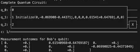

  1. However, when we implement the below code, we still have a phase shift.
#qc2 is stage3. Bob implement operation.
qc2 = QuantumCircuit(3, 1,global_phase=0)
#typing measured output and feed into bob's quantum circuit will be implemented.
qc2.initialize(statevector_alice, [0,1,2])
Apply corrections to Bob's qubit based on Alice's measurement result
if alice_measurement_result[0] == '1': qc2.z(2) if alice_measurement_result[1] == '1': qc2.x(2) print("Complete Quantum Circuit:") print(qc2) job_bob = execute(qc2, simulator, shots=1) result_bob = job_bob.result() statevector_bob = result_bob.get_statevector() print("Measurement outcomes for Bob's qubit:") print(statevector_bob)
bob's measurement I know that in real, Bob also has to measure his qubit, but in a simulation, we want to get the same compound state vector as our input. Also, I know that there is no need to run quantum teleportation simulation by parts like this, and it won't work in IBM Quantum, but for our purpose, running well in our local computer on the Qiskit is enough.

Qiskit uses little-endian bit ordering (see this answer for details). It seems that you didn't take that into consideration in some places in your code. For example, to tensor product init_statevector with statevector_bell such that init_statevector is the first qubit you should use:
compound_statevector = statevector_bell.tensor(init_statevector)
instead of
compound_statevector = init_statevector.tensor(statevector_bell)
You may need to review all your code to make sure there are no other issues related to bit ordering.
Also, you should switch $X$ and $Z$ gates while applying the correction.
