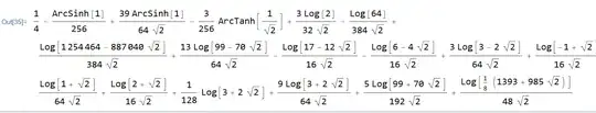

$$ \begin{align} d{\psi}\equiv\frac{\Gamma(d)}{2\pi^d}\delta\Big(1-\sum_{j=1}^d r_j\Big)\ \prod_{j=1}^d dr_jd\theta_j. \end{align} $$ Here $\Gamma(d){=}(d-1)!$ is the Gamma function. First, let us check if the above parameterisation agrees with the $d{=}2$ case. In this case, $|\langle \psi |Z|\psi\rangle|{=}|r_1-r_2|$, and the integral $I_{d=2}$ becomes $$ \begin{align} I_{d=2}&= \frac{1}{4\pi^2}\int_{r_1{=}0}^1\int_{r_2{=}0}^1 |r_1-r_2|\delta\Big(1-r_1-r_2\Big)dr_1dr_2 \int_{0}^{2\pi}\int_{0}^{2\pi} d\theta_1d\theta_2 \\ &=\int_{r_1,r_2{=}0}^1 |r_1-r_2|\delta\Big(1-r_1-r_2\Big)dr_1dr_2\\ &{=}\frac{1}{2}. \end{align} $$ Then I moved on to $d{=}3$, in which case, $|\langle \psi |Z|\psi\rangle|{=}|r_1+\omega r_2 + \omega^2 r_3|$, with $\omega{=}\exp(\frac{i2\pi}{3})$. With little intention to work it out myself, I fed it to Mathematica and found $I_{d=3}=\frac{1}{3}+\frac{\ln(2+\sqrt{3})}{6\sqrt{3}}{\approx}0.460058$, not conforming to my guess, $\frac{1}{\sqrt{d+2}}$. Similarly, I calculated for $I_{d=4}{\approx}0.405806$ with a clumsy analytical expression as shown in the attached screenshot.
Analytical expression for I_{d=4}
I cross-verified the evaluation with numerical estimations with $10^6$ samples. Here are the list of numerical results for $d{\in}[2,6]$, $[0.4998, 0.4600, 0.4058, 0.3695, 0.3409]$.
So at this stage, I don't have much intuition about the general analytical expression. However the upper bound of $\frac{1}{\sqrt{d+1}}$ is helpful. I will be open to further interesting perspectives on this.
