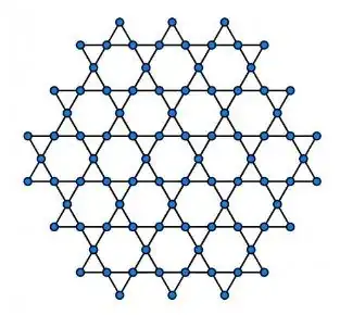

This was also partly inspired by Sandy Irani's presentation at the Israeli Institute for Advanced Studies here, where she mentions frustration in the context of a Kagome lattice.
Kagome Lattice
I gathered from her talk that the Kagome lattice puts some stress on naive implementations of classical many-body algorithms like DMRG, but nonetheless from clever DMRG simulations there's some evidence that the lattice does indeed have a uniquely quantum (non-degenerate and highly entangled) ground state.
