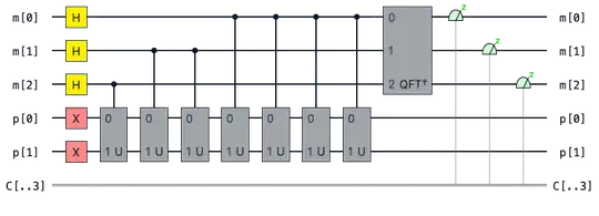

How would you draw the phase-estimation circuit for the eigenvalues of:
$U = \mathrm{diag}(1,1,e^{(\pi i)/ 4}, e^{(\pi i)/8}) $
corresponding to the eigenstates $|10\rangle$ and $|11\rangle$?
What is the state prior to the measurement?
Also how many additional qubits would be needed to get a good estimation?

What does the circuit look like? See the diagram below. This one uses 3 measurement qubits and the eigenstate is $|11\rangle$. Here I prepare the $|11\rangle$ with two Pauli $X$ gates. You could also prepare a linear combination of eigenstates instead if you like.
What is the state prior to measurement? For $m=4$ measurement qubits the state will be $|0001\rangle$. If we use $m=3$ instead we end up with an equal superpositon of $|000\rangle$ and $|001\rangle$.
How many qubits to get a good estimate? In this case we can exactly estimate the phase with $m=4$ measurement qubits. In general more qubits means more precision at the expense of a larger circuit.

In your case the circuit will look something like the diagram below. There are several variants of phase estimation but I've gone with the "textbook" one.
  1. Here I have used $m = 3$ measurement qubits to estimate the phase of $U$. The number of controlled $U$ operations increases exponentially with $m$.
  2. Note that here I am using the two Pauli X gates to prepare the $|11\rangle$ eigenstate of $U$.
  3. At the end of the circuit we apply the inverse quantum Fourier transform (QFT†) before measuring our qubits.
Please note: The circuit here uses 3 measurement qubits to estimate the phase. This is actually not quite enough for an exact measurement of the phase as $\theta = 1/16 = 1/(2)^4$. We need four qubits here (see the calculation below). If we run this circuit we will get the results $|000\rangle$ and $|001\rangle$ with roughly equal probability. This is because our true result ($\theta=1/16$) is halfway between $1/8$ and $0$.
