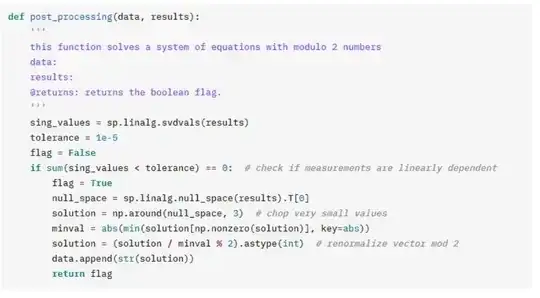

The latter is underlined by the fact that Google's Cirq uses svd (Singular Value Decomposition) that I don't understand yet.
