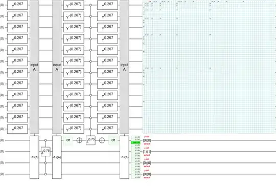

Hmmm... it appears that what I call the "$k$-hot" state is also known as a Dicke state. In "Deterministic Preparation of Dicke States" by Andreas Bärtschi and Stephan Eidenbenz can prepare just such a state with only $O(nk)$ gates. This Quirk circuit from their paper gives the $3$-hot Dicke state on five qubits.

Here's a quirk circuit showing it works:
