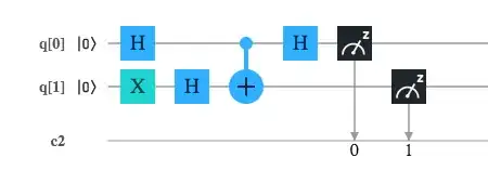

For example, if take the following circuit as the input (either QASM or Qiskit):
qreg q[2];
creg c[2];
x q[1]; h q[0]; h q[1]; cx q[0],q[1]; h q[0]; measure q[0] -> c[0]; measure q[1] -> c[1];
The expected output will be:
layer[0] = [H [q0], X [q1]]
layer[1] = [H [q1]]
layer[2] = [cnot [q0] [q1]]
layer[3] = [H [q0]]
layer[4] = [measure [q0]]
layer[5] = [measure [q1]]
Is there a Qiskit function to achieve this? If not, suggestions to implement this task are also welcomed.

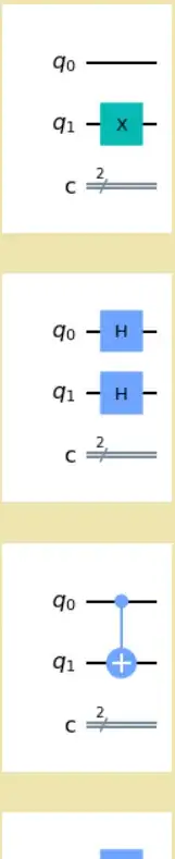

You can decompose a quantum circuit into layers using DAGCircuit.layers() method:
from qiskit.converters import circuit_to_dag, dag_to_circuit
from IPython.display import display
dag = circuit_to_dag(circ) for layer in dag.layers(): layer_as_circuit = dag_to_circuit(layer['graph']) display(layer_as_circuit.draw('mpl'))
where circ is a QuantumCircuit. The output will be:
DAGCircuit.layers() method constructs the layers using a greedy algorithm.

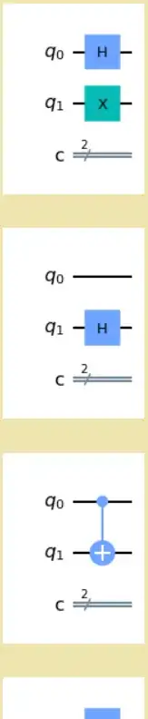

You can also break down your circuit into layers based on some scheduling policy. In the following example we apply an "as late as possible" (ALAP) scheduling policy:
from qiskit.transpiler import PassManager, InstructionDurations
from qiskit.transpiler.passes import  ALAPScheduleAnalysis, PadDelay
Apply the scheduling policy:
instruction_durations = InstructionDurations( [ ("h", None, 160), ("x", None, 160), ("cx", None, 800), ("measure", None, 1600), ] )
pass_manager = PassManager( [ ALAPScheduleAnalysis(instruction_durations), PadDelay(), ] ) transpiled_circ = pass_manager.run(circ)
Use DAGCircuit.layers() method with the transpiled circuit:
dag = circuit_to_dag(transpiled_circ) for layer in dag.layers(): layer_as_circuit = dag_to_circuit(layer['graph']) # Remove the Delay instructions: for _inst in layer_as_circuit.data: if _inst.operation.name == 'delay': layer_as_circuit.data.remove(_inst)
The result:
Similarly, you can apply "as soon as possible" (ASAP) scheduling policy.
