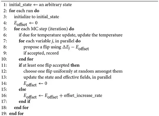

The first google search gives the research paper by Aramon et al. According to the article:
The Fujitsu Digital Annealer is designed to solve fully connected quadratic unconstrained binary optimization (QUBO) problems. It is implemented on application-specific CMOS hardware and currently solves problems of up to 1,024 variables. The Digital Annealer's algorithm is currently based on simulated annealing; however, it differs from it in its utilization of an efficient parallel-trial scheme and a dynamic escape mechanism. In addition, the Digital Annealer exploits the massive parallelization that custom application-specific CMOS hardware allows.
So basically, it is specialized hardware that runs a variant of the simulated annealing algorithm.
The algorithm is explicitly given in the article as well. here
