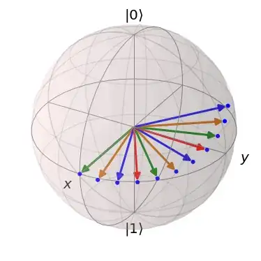

This seems to work and the corresponding output looks as follows:

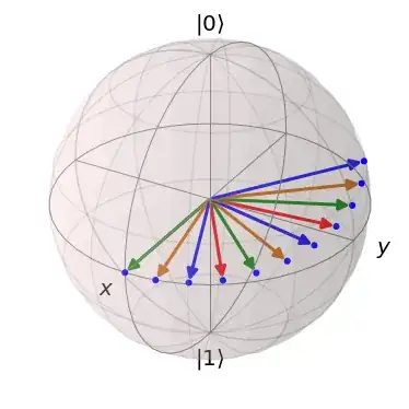

Update 2022-03-20: Thanks to the unveiling answer here, the $SU(2)$ rotations look good and correct:

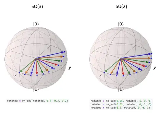

What remains is the question: How do you have to rotate so that both point sequences look the same? In the $SO(3)$ implementation case I used rotated = rn_so3(rotated, 0.4, 0.3, 0.2) and to get an almost same looking picture, by trial and error, I obtained for the $SU(2)$ implementation:
rotated = rn_su2(0.05, rotated, 1, 0, 0)
rotated = rn_su2(0.02, rotated, 0, 1, 0)
rotated = rn_su2(0.2, rotated, 0, 0, 1)
How are the angles to be used related in both cases?
