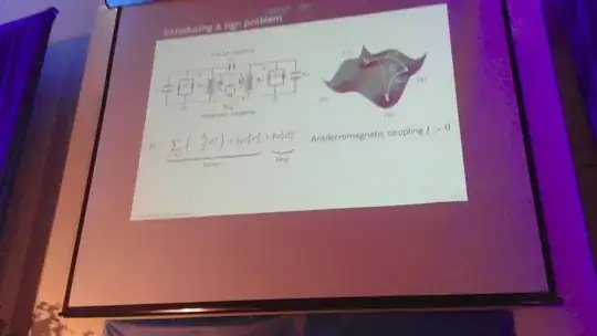

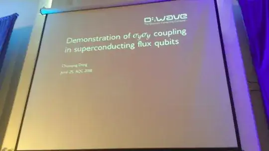

Well I have good news for you. Four days ago D-Wave announced at the AQC conference that they can now do YY coupling:
Here you can see the superconducting circuit that gives you ZZ and YY coupling at the same time:
I cannot show you more of their "preview" presentation, but expect for them to publish something very soon.
Why is YY coupling significant? It is because in 2007, Jacob Biamonte and Peter Love from D-Wave proved that XX + ZZ is enough for universal quantum computation. XX and YY are equivalent up to a rotation, so they could easily have instead said that YY + ZZ is universal.
Now that D-Wave has engineered a universal set of couplers, it should be possible to have a 10,000 qubit universal quantum computer when they extend to 1250 units cells (since 8 x 1250 = 10,000, see my first answer).
