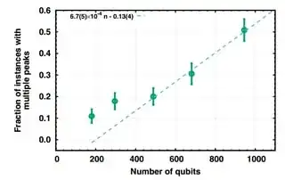

Here is another example from 2017 where 1000 qubits are simulated:
Here's an example from 2015 where 1000 qubits are simulated (it says bits rather than qubits, but they are the qubits of the D-Wave device):
