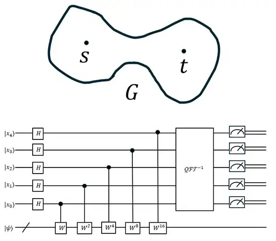

I'd like to know if there's anything that can be said about whether and when we can efficiently prepare a state corresponding to the second-lowest eigenvalue $|\lambda_1\rangle$ of a given Hamiltonian, or in any other way learn what this energy is?
For example, let $G$ be a sparse, $d$-regular graph having adjacency matrix $A$ with Laplacian $\mathcal L=dI-A$. We can simulate $W=\exp(-i\mathcal L t)$ easily enough.
My intuition, which I don't know how to formalize, is that given two vertices $s$ and $t$ that are far from each other, even across a (Cheeger) bottleneck, the spectral decomposition of a superposition such as:
$$\vert\psi\rangle=\frac{1}{\sqrt{2}}(\vert s\rangle-\vert t\rangle)$$
likely has a large component corresponding to this second-lowest eigenstate.
Example of Approach
Indeed Guoming Wang's paper on quantumly measuring the resistance between nodes reminds us that the resistance metric is based on this Laplacian; the bottleneck between $s$ and $t$ certainly increases the resistance therebetween.
Surely if $G$ is disconnected, with $s$ on one component and $t$ on another component, then this may be very hard. But if $G$ is otherwise promised to be connected, e.g., is $|\psi\rangle=\frac{1}{\sqrt 2}\big(|s\rangle-|t\rangle\big)$ a good ansatz, is $|\lambda_1\rangle$ accessible through eigenvalue sampling of $|\psi\rangle$?
