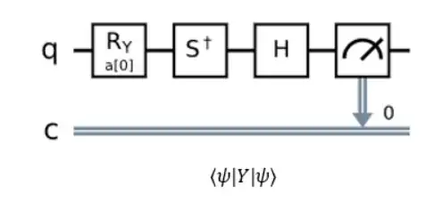

If your Hamiltonian has a Pauli $Y$ in it, then you need to calculate $$\langle \psi | Y | \psi \rangle = \langle \psi | HSZHS^\dagger |\psi \rangle = \langle \psi HS | Z | HS^\dagger \psi \rangle $$ This means you need to first apply $S^\dagger$ follow by the Hadamard gate $H$ to your circuit before measuring in the computational (Z) basis. This can be visualized by the following circuit:
