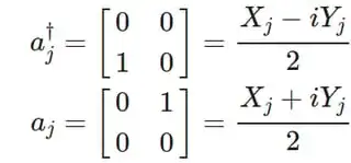

You can simply transform creation and annihilation operators into "occupied" and "unoccupied" operators:
But you have to also make sure the wavefunction satisfies the anti-symmetric property for fermions, so you have to add strings of $Z$ operators to count the number -1's (this is the Jordan-Wigner transformation which is $n-local$):
The occupation operator in the first part of your question is simply:
To get the other operators in your question, you can just substitute the $a_j$ and $a^\dagger_j$ expression from above.
