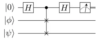

It's creating a real confusion for me especially the parameterized circuit which I have to create. Can anybody please solve this for me? I want to create this circuit.

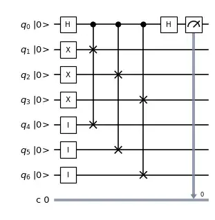

Assuming that you are not trying to keep $|\psi \rangle$ and $|\phi\rangle$ for further computation after measuring the ancilla qubit then you can do it as follows:
Let's suppose $|\phi\rangle = |111\rangle$ amd $|\psi \rangle = |000\rangle$ , then you can execute it as:
where $I$ is the identity operator. It doesn't need to be there because the qubits start in the state $|0\rangle$. I just put them there as a place holder.
Now this can be done with qiskit as:
import numpy as np
from qiskit import QuantumCircuit, QuantumRegister, ClassicalRegister
num_qubits = 3 circuit1 = QuantumCircuit(num_qubits) for i in range(num_qubits): circuit1.x(i)
circuit2 = QuantumCircuit(num_qubits) for i in range(num_qubits): circuit2.id(i)
swap_test_circuit = QuantumCircuit(2*num_qubits + 1,1) swap_test_circuit.compose(circuit1, qubits=[1,2,3], inplace=True ) swap_test_circuit.compose(circuit2, qubits=[4,5,6], inplace=True ) swap_test_circuit.h(0) for i in range(num_qubits): swap_test_circuit.cswap(0,i+1,i+4) swap_test_circuit.h(0) swap_test_circuit.measure([0],[0])
