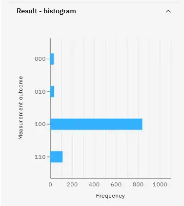

  1. Let's say I have $U|ψ⟩=e^{2πi\frac{9}{16}}|ψ⟩$ (so the angle is $0.1001$ in binary). Now I use n=2 so $2^n=4$ (i.e. I am using two ancilla qubits with $U$ and $U^2$). So now I can say that I will get $ \frac{1}{2}, \frac{1}{2} \pm \frac{1}{8}$ or $\frac{1}{2} \pm \frac{1}{4}$ with prob ≥$ \frac{8}{π^2}$, but I will get $ \frac{1}{2}$ or $\frac{1}{2} \pm \frac{1}{8}$ with prob ≥$ \frac{4}{π^2} $ .
  2. Amplitude estimation is an application of phase estimation procedure to estimation the eigenvalue of the Grover iteration G, which in turn enable us to determine the amplitude of the initial state.
QPE:
Considering the phase $\varphi=\frac{9}{16}$, we use two bits to estimeate $\varphi=0.1001$. If the outcome of the final measurement is $ 10$, we obtain a pretty good estimate to $\varphi$(i.e., $\varphi$ is expressed exactly in two bits).
And supposing we wish to approximate $\varphi$ to an accuracy $2^{-1}$(i.e., $|\hat{\varphi} - \varphi| \le \epsilon =2^{-2}$), that is $\frac{-1}{4}\le \hat{\varphi} - \frac{1}{2} \le \frac{1}{4}$. The output of measurement is $\hat{\varphi}*2^2$, with the probability of success at least $P(|\hat{\varphi} - \varphi| \le 2^{-2}$)
IBM Q circuit use 'simulator_statevector'
