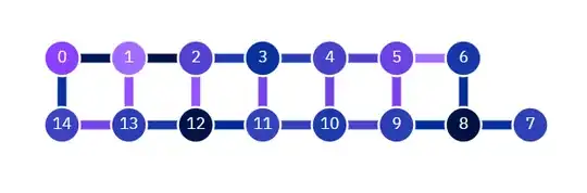

What is the meaning of the topology graphs of IBM's quantum computers? How should it be interpreted? For example, how should I understand the following graph?enter image description here

The graph shows you how the physical qubits are connected together on the real device you will be using. For example, on the graph you put, qubit 0 has a physical connection to qubit 1 and qubit 14 on the quantum device but is not connected to qubit 12.
This graph is really important when Qiskit tries to map a circuit to the quantum device because it shows how qubits are connected and this is a huge step in transforming circuits to run in devices. For example, since 0 and 1 are connected, it will have no problem executing a C-NOT between the two. But if you wish to do the same between 0 and 12, this will be harder because of the lack of connection.
The process of rewriting circuits is what we call transpilation. Without it, we won't be able to run circuits on quantum devices. You should check the link I just put, it explains it quite well! All in all, the main objective of this is to transform your circuit so it matches the device you are using, and the topology of the qubits (the graph) plays quite a important role in this.

The plot topology graph of the device represents the qubit layout of the hardware. The qubits on IBM hardware are fixed. They don't move around as trapped-ion qubits built by Honeywell system. Hence, IBM hardware doesn't have what you would call all-to-all connectivity between qubits. Note that IBM uses superconducting transmon qubit rather than trapped ions qubits.

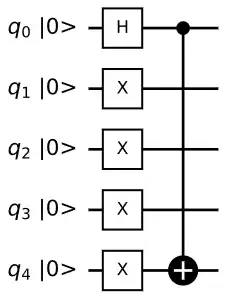

For example, let's suppose that the following quantum circuit solve that problem that you are interested in:

First, we must note that the Hadamard gate can't be implement directly on ibmq_vigo since it is not part of the native gate. So it need to be decomposed into RZ and SX gates.
Second, we should note that qubit $q_0$ is not connected to $q_4$ in the above qubit layout. But we do have a $CX$ gate between $q_0$ and $q_4$ hence there must be some overhead swapping operations need to be done for us to be able to execute the above circuit on the hardware.

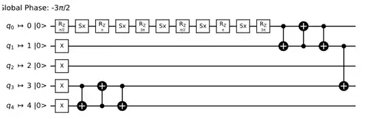

But as I said before, IBM do this transpilation for you automatically, so you don't have to worry about it. And they do it at different level of optimization. At the lowest level, that is, you just map the your circuit $q_0$ to the device qubit number $0$, and your circuit $q_1$ to the device qubit number $1$, and so on, then you would have a transpiled circuit like:
Note how you don't see the Hadamard gate $H$ being executed but rather a sequence of $RZ$ and $SX$ gates putting together... again this is because the QPU ibmq_vigo doesn't have $H$ as the native gate.

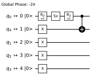

This is all good, but you might look at your circuit, and say to yourself: well... since $q_0$ and $q_4$ need to have to an entangled gate, $CX$, and the other qubits only have single qubit rotation ($X$ gate). Why don't we map qubit $q_0$ of the circuit to qubit number $0$ on the QPU, but now mapping qubit $q_4$ of the circuit to qubit number $1$ of the device, and qubit $q_1$ of the circuit to qubit number $2$ of the device and etc. This will reduce the overhead. This is a higher level of optimization, and it is a default option in Qiskit (I believe). So doing what I just said above will give is the following circuit:
Note how much simpler it is now compare to the our first transpiled circuit. This is why having a good transpilation process is really important and one that is very critical in this NISQ (Noisy Intermediate-Scale Quantum) era.

Pick ibmq_vigo as our QPU to transpile the original circuit to, also transpile it naively (lowest level of optimization): (This is create that humongous long circuit we saw earlier)
hardware_backend = provider.get_backend('ibmq_vigo')
transpiled_qc_lvl0 = transpile(qc, backend = hardware_backend , optimization_level=0)
transpiled_qc_lvl0.draw('mpl', style = {'name': 'bw'}, scale = 0.6, initial_state = True,plot_barriers = False)
Transpile the original circuit with highest level of optimization: (This spit out the shorter/much more compact transpiled circuit that we saw earlier. Not we just change the optimization_level from 0 to 3.)
transpiled_qc_lvl3 = transpile(qc, backend = hardware_backend , optimization_level=3)
transpiled_qc_lvl3.draw('mpl', style = {'name': 'bw'}, scale = 0.75, initial_state = True,plot_barriers = False)
