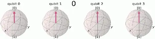

To see how the QFT relates to more familiar Fourier transforms, it may be helpful to consider how integers are represented over both the computational basis and the Fourier basis. To illustrate, I'll walk through a specific example of the QFT for a four-qubit system.
In the computational basis, integers are represented in binary form (with the MSB on the left by convention). So for four qubits $$\vert 0 \rangle=\vert 0000 \rangle, \;\;\vert 1 \rangle=\vert 0001 \rangle, \;\; \vert 2 \rangle=\vert 0010 \rangle,\;\; ..., \;\; \vert 15 \rangle =\vert 1111 \rangle.$$ Algebraically this is given by $$\vert n \rangle=\vert a(2^3)+b(2^2)+c(2^1)+d(2^0) \rangle=\vert abcd \rangle, \;\; a,b,c,d \in \lbrace 0,1 \rbrace, \; n \in \lbrace 0,...,15\rbrace.$$ On the four Bloch spheres associated with $\vert abcd \rangle$, counting from $\vert 0 \rangle$ to $\vert 15 \rangle$ looks like: Computational Basis Counting (Image Source, with $\vert d \rangle=\text{qubit 0}$, $\vert c \rangle=\text{qubit 1}$, ...)
You can see that in the Bloch spheres representation, distinct values of $\vert n \rangle$ are distinguished by ordered sets of qubits at either their north pole, $\vert 0 \rangle$, or their south pole, $\vert 1 \rangle$. Intuitively, while counting, the qubit associated with the LSB, $\vert d \rangle$, changes state every step, whereas the qubit associated with the MSB, $\vert a \rangle$, changes state every eighth step. [Note that the Bloch sphere is actually a Riemann sphere (i.e. the complex projective line), so orthogonal states, such as $\vert 0 \rangle$ and $\vert 1 \rangle$, are represented by antipodal points.]

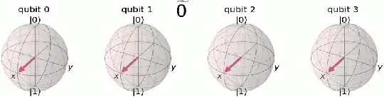

The same 16 integers represented over the Fourier basis, $ \text{QFT} \vert n \rangle = \vert \tilde n \rangle =\vert \tilde a \tilde b \tilde c \tilde d \rangle $, is given algebraically by $$\vert \tilde n \rangle = \tfrac{1}{\sqrt{2^4}}(\vert 0 \rangle + e^{2\pi in/2} \vert 1 \rangle) \otimes (\vert 0 \rangle + e^{2\pi in/2^2} \vert 1 \rangle) \otimes (\vert 0 \rangle + e^{2\pi in/2^3} \vert 1 \rangle) \otimes (\vert 0 \rangle + e^{2\pi in/2^4} \vert 1 \rangle).$$ Now as we count in the Fourier basis from $\vert \tilde n \rangle = \vert \tilde a \tilde b \tilde c \tilde d \rangle = \vert \tilde 0 \rangle$ to $\vert \tilde {15} \rangle$ all four qubits change state every step, with $\vert \tilde a \rangle$ taking the largest steps (i.e. swapping between $\vert + \rangle$ and $\vert - \rangle$, which is $\frac{1}{2}$ of a turn per step) and $\vert \tilde d \rangle$ taking the smallest steps ($\frac{1}{16}$ of a turn per step).
On the four Bloch spheres associated with $\vert \tilde a \tilde b \tilde c \tilde d \rangle$, counting in the Fourier basis appears as each qubit state rotating in the equatorial plane with decreasing frequency from $\vert \tilde a \rangle$ to $\vert \tilde d \rangle$.
Fourier Basis Counting (Image Source, with $\vert \tilde d \rangle=\text{qubit 0}$, $\vert \tilde c \rangle=\text{qubit 1}$, ..., $\vert + \rangle = x$)
In a single counting sequence from $\vert \tilde 0 \rangle$ to $\vert \tilde {16} = \tilde 0 \, (\text{mod} \, \tilde {16}) \rangle$ the qubits associated with $\vert \tilde a \rangle, \, \vert \tilde b \rangle, \, \vert \tilde c \rangle$, and $\vert \tilde d \rangle$ make exactly $2^3, \, 2^2, \, 2^1$, and $2^0$ full rotations in their respective equatorial planes. Similarly, if we consider "no rotation" in the equatorial plane as the state $H\vert 0 \rangle=\vert+\rangle$, then $\vert \tilde 0 \rangle = \vert ++++ \rangle$ gives all qubits unrotated, while $\vert \tilde {15} \rangle$ gives all qubits at their maximal rotation (in the positive direction). [Note that the single qubit QFT is just the Hadamard gate, $H$. In turn, $H$ is simply the 2-level DFT as noted in this previous answer.]
In this example you can see how the high magnitude associated with $\vert a \rangle$ as a constituent of $\vert n \rangle$ in the computational basis corresponds to a high frequency associated with $\vert \tilde a \rangle$ as a constituent of $\vert \tilde n \rangle$ in the Fourier basis, and so forth for $\vert b \rangle \,, \vert c \rangle$, and $\vert d \rangle$. Hopefully this helps to make the analogy between QFT and DFT more tangible.
