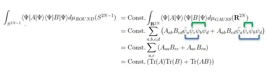

When $U$ uniformly scans the unitary group manifold, $ |\Psi\rangle$ will uniformly scan a $2N-1$ dimensional round sphere. This is because the metric of a round sphere is Haar. Thus, we need to evaluate an integral of the form:
$$\int_{S^{2N-1} }\langle\Psi| A |\Psi \rangle \langle\Psi| B |\Psi\rangle d\mu_{\small{ROUND}}(S^{2N-1}) $$
The integrand is a homogeneous polynomial of the components of the unit vector $ |\Psi\rangle = \sum_{a=1}^N \psi_a |a\rangle$:
$$\langle\Psi| A |\Psi \rangle \langle\Psi| B |\Psi\rangle = \sum_{a,b,c,d} A_{ab} B_{cd} \bar{\psi_a}\bar{\psi_c}\psi_b \psi_d$$
Integrals of homogeneous polynomials on the sphere can be evaluated as Gaussian integrals up to an overall normalization, which can be computed from a trivial particular example. In this case we can use the Wick's theorem:
The constant can be evaluated by taking $A=B=I_{N\times N}$, we get:
$$\mathrm{Const.} = \frac{1}{N(N+1)}$$
