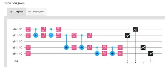

The state, in which I am trying to calculate the expectation values, is prepared using a simple circuit
q_0: ─────┤ RY(-1.8018) ├──■────────■───────┤ X ├────────────────────
q_1: ┤ X ├───────■───────┤ X ├──────┼─────────┼──────────────────────
q_2: ─────────────────────────┤ RY(2.2489) ├──■─────────■───────┤ X ├
q_3: ────────────────────────────────────────────┤ RY(0.99778) ├──■──
which after transpiling looks as follows: enter image description here

I tried to run your code with the same backend as you, ibmq_ourense, and also got the same kind of bad results. Although, I also tried on other backends, first the ibmq_qasm_simulator and I got the exact expectation value, so I assume there is no bug on your code since it is right with the ideal machine. I also tried with ibmq_vigo, which has a better quantum volume than ibmq_ourense(16 vs 8), and I got much better results, closer to the exact expected value.
You could try the "obvious ways" to get better results as you mentioned in your question, maybe looking at the different levels of optimization in the transpile function might help, see the documentation and a tutorial from Qiskit to check how you can play with this!
Finally running your code on a device with a higher quantum volume leading to less noise thus better results might be another way around the errors!
