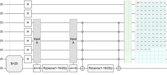

For large $N$ the most efficient method I am aware of is to prepare a uniform superposition over $2^{\lceil \log_2(N) \rceil}$ values with a bunch of Hadamard gates, then use a perfectly tuned Grover diffusion step to remove the unwanted states between $N$ and $2^{\lceil \log_2(N) \rceil}$. The cost of this approach is $O(\log N + \log 1/\epsilon)$ gates (the $1/\epsilon$ is from arbitrary angle rotations being approximated using a fixed gate set).
This method is explained in Figure 12 of https://arxiv.org/abs/1805.03662. Beware that there is a sign error in the figure. The numerator in the angle calculations should be $L - 2^{\lfloor \log(L)\rfloor}$ instead of $ 2^{\lfloor \log(L)\rfloor} - L$.
Here is a working example in Quirk, preparing a uniform superposition over 100 values. 100 is $25*2^2$, so this really reduces to the $N=25$ case with two $|+\rangle$ qubits. The perfect angle for the diffusion is $\arccos(1 - 16/25)$, where the 25 comes from $N=25$ and 16 is the smallest power of 2 less than $N$.
Quirk circuit
You can confirm that the construction works by clicking on the image to open quirk, changing the three "25"s in the circuit to "23"s, and seeing that the new output is a uniform superposition up to 4*23 = 92.

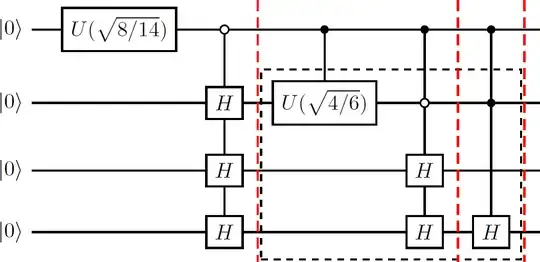

I'm not quite sure why using Grover is cheating, or what the motivation is for discounting measurement. However, there is a way of thinking about an algorithm without either. It also runs as $O(m^2)$ where $m=\lceil\log_2(n)\rceil$.
Consider the value $n$. We write $n-1$ in binary as $x$, comprising $m$ bits. We know that the first (most significant) bit of $x$ must be 1.
We're going to describe an iterative protocol. In the first step, we start with $|0\rangle^{\otimes m}$, and convert the first qubit to $$ \sqrt{\frac{2^{m-1}}{n}}|0\rangle+\sqrt{\frac{n-2^{m-1}}{n}}|1\rangle. $$ Controlled off the first qubit being 0, we apply Hadamard on all other qubits. This has got all the terms $|0y\rangle$ for $y\in\{0,1\}^{m-1}$ correct. Now we just have to worry about the $|1y\rangle$ terms. If the second bit of $x$ is 1, then we essentially just repeat the first step but for the $m-1$ least significant bits, and controlling every operation off the first qubit being in 1. If the second bit of $x$ is 0, then we move onto the third bit, but now controlling everything off the first qubit being 1 and the second qubit being 0 (except that we don't actually need that control because it's always 0 if the first qubit is 1). We can now just repeat this for the entire sequence.
For example, if $n=14$ ($x=1101$), you'd do something like \begin{align*} |0\rangle^{\otimes 4}&\rightarrow \sqrt{\frac{6}{14}}|1000\rangle+\frac{1}{\sqrt{14}}(|0000\rangle+|0001\rangle+|0010\rangle+|0011\rangle+|0100\rangle+|0101\rangle+|0110\rangle+|0111\rangle) \\ &\rightarrow \sqrt\frac{6}{14}|1\rangle(\sqrt\frac{2}{6}|100\rangle+\frac{1}{\sqrt{6}}(|000\rangle+|001\rangle+|010\rangle+|011\rangle))+\frac{1}{\sqrt{14}}(\ldots) \\ &\rightarrow\sqrt\frac{6}{14}|1\rangle\sqrt\frac{2}{6}|10\rangle\frac{1}{\sqrt{2}}(|0\rangle+|1\rangle)+\ldots \end{align*} To see the complexity, we've got to loop over the $m$ bits of $x$, and each step, at worst, we have to perform a multi-controlled not, which can be decomposed in terms of $O(m)$ controlled-nots. enter image description here In this circuit diagram, I defined $U$ such that $U(x)|0\rangle=x|0\rangle+\sqrt{1-x^2}|1\rangle$. The slices correspond to the stated outputs in the example, and the dashed box hopefully guides the eye about the recursive structure. Note that for the very last gate, $U(1/\sqrt{2})=H$. I should also note that there are some case specific optimisations that can be made (all the gates on the last qubit can be combined as a single, uncontrolled, Hadamard) but that only obfuscates the algorithmic structure.
