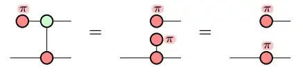

I am going to assume that $|0\rangle$ is represented by enter image description here, and $|1\rangle$ by enter image description here.
Then, enter image description here represents the bit-flip, or NOT gate. What it does is: $|x\rangle\mapsto |x\oplus1\rangle$. This can be verified easily in the graphical calculus, using the "spider" rule:
and
Now, by definition, CNOT controls NOT: $|x_1,x_2\rangle\mapsto|x_1,x_1\oplus x_2\rangle$. In other words, if $|0\rangle$ is fed to the first qubit, the result is $|0\rangle$ on the first qubit, and the identity on the second. If it is fed $|1\rangle$, the result is $|1\rangle$ on the first qubit, and the gate NOT on the second one. Again this can be verified in the graphical calculus:
where the first equality is the "copy" rule, the second is the "spider" rule, and the last one is the fact that a rotation of angle $0$ is the identity.
Similarly:
where the first equality is the "$\pi$-copy" rule, and the second is the "spider" rule.
