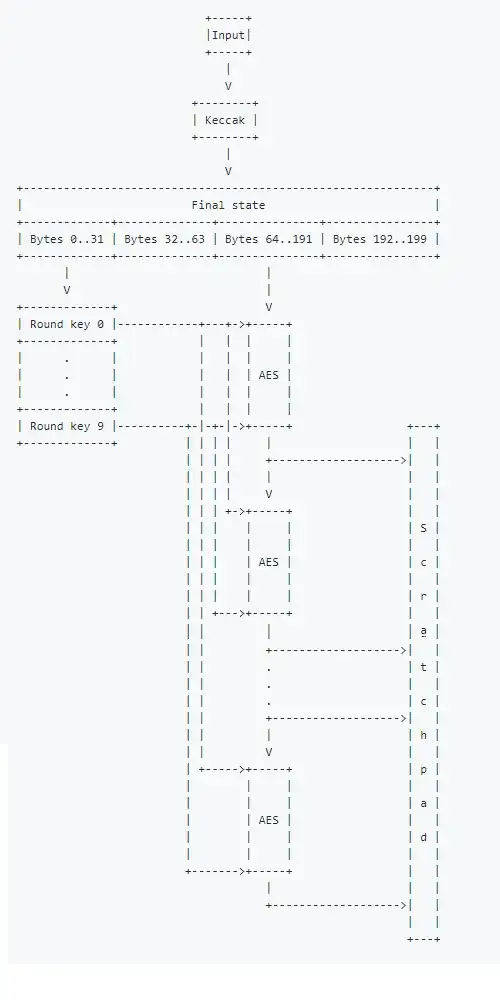

from hardlydifficult's explainer, this AES round is described as:
"... near standard AES encryption. Each block is encrypted using each round key, sequentially (so 8 blocks * 10 rounds per block means 80 AES rounds so far). The only difference from AES encryption is the 'initial round' and 'final round' as described here are excluded."
it's "near standard" because you need to:
"... Note that unlike in the AES encryption algorithm, the first and the last rounds are not special."
Here's the scratchpad initialization diagram from the explainer:
