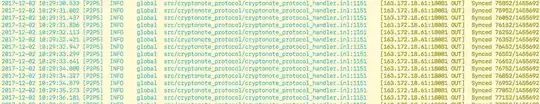

The daemon tells the wallet that the wallet should be looking for a top block of 1,445,692 (per the daemon log snippet). The wallet, therefore, knows that it is not in sync with the blockchain. The wallet will only be confident in its balance and allow you to spend those funds once it thinks it is fully synced.
You might as well wait until the daemon is fully synced before opening up the wallet. Alternatively, you could open the wallet with the --daemon-host flag. This answer details several ways of operating a wallet without downloading the blockchain.
