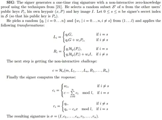

I was asking myself the same thing. Looking at the CN whitepaper again, we see that the ring signature is composed of the public keys + the key image.

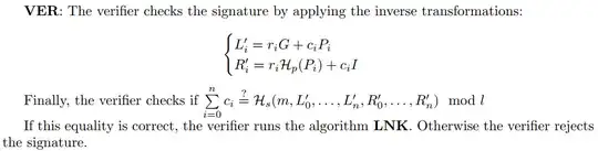

Similarly, the signature checking alghoritm involves key image as part of it.
If the signature is ok, the verifier checks whether it had already been used, effectively preventing double-spends.
Finally, there are some general notes about the whole mechanism.

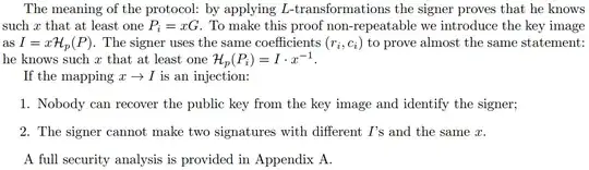

And that answers the question - the coefficients (r_i, c_i) are used by the signer to prove that he knows such x that at least one H_p(P_i) = I * x^-1, effectively proving that it's one from the ring.
