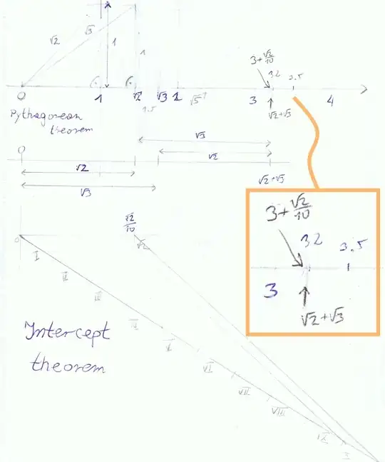

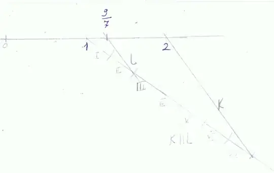

Tools: Ruler, compass and pencils

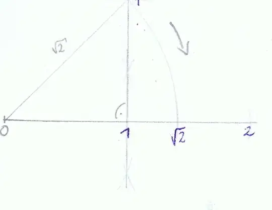

I. Pythagorean theorem (only)

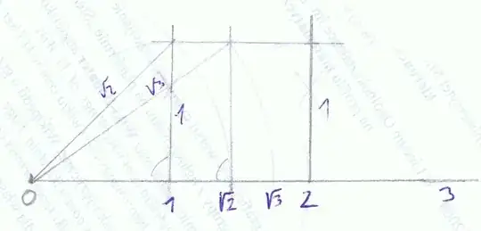

I.1.How to lie $\sqrt{2}$: enter image description here I.2. Step I.1. is required to create $\sqrt{3}$ enter image description here Next are $\sqrt{4}=2$; $\sqrt{5}$;$\sqrt{6}$...
Recursion is not required by starting $\sqrt{1^2+1^2}$- roots like $\sqrt{19}$ can be create from $\sqrt{4^2+(\sqrt{3})^2}$

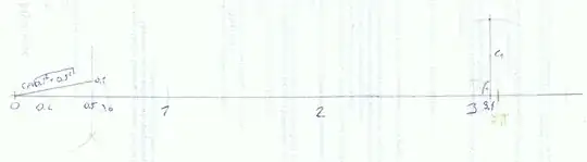

I.3. Set $\pi$ as approximation of $\pi^2$: $$ \pi^2\leq 0.1^2+0.5^2+3.1^2 $$ enter image description here II. The next important theorem to pythagorean is the intercept theorem

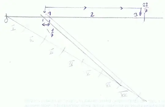

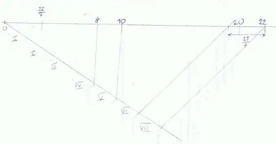

II.1. An example on $\frac97$: enter image description here II.2. An approximation for $\pi\approx\frac{22}{7}$:
Sample way 1: enter image description here Sample way 2: enter image description here III. Combine both theorem- Interval $\pi$: $$3+\frac{\sqrt{2}}{10}<\pi<\sqrt{2}+\sqrt{3}$$ enter image description here
IV. Bonus: the golden ratio $\phi$ (and $2\phi$) I have draw (for here):$\phi=\frac{1+\sqrt{5}}{2}$ enter image description here
