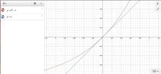

$$f'(x)=\lim_{h\to0}\frac{e^x(e^h-1)}{h}$$
Now notice that as $h$ approaches $0$ the denominator of the fraction $h$ and the term $e^h-1$ also approach $0$. Furthermore, when being really close to $0$ they approach it at 'the same speed' and we say they are 'equivalent infinitesimals' which means that we can approximate one to the other. We can substitute then $e^h-1$ with $h$.
With this in mind we end up with:
$$f'(x)=\lim_{h\to0}\frac{e^x·h}{h}$$
We can cancel the $h$ and get to the final result:
$$exp'(x)=exp(x)$$

  • What would be a explanation that $\lim_{h\to0}a^h-1\not=h$ for $a\not=e$ – kingW3 Oct 18 '14 at 12:06
  • @kingW3 Note that $\lim_{h\to0}a^h-1$ can also be expressed as $\lim_{h\to0}e^{ln(a^h)}-1=\lim_{h\to0}e^{h·ln(a)}-1$which is the same case as stated above but with $h·ln(a)$ replacing $h$, which means we can aproximate $a^h-1$ to $h·ln(a)$ – Ioannes Oct 18 '14 at 17:30
