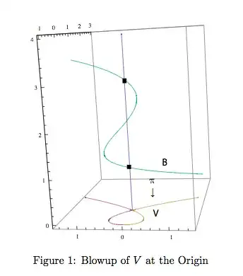

Here is some pictures from an undergrad paper, I think this helps get an intuition for how blowing up separates the slopes at 0. Here we have a node $y^2 -x^2(1+x) = 0$ and a cusp $x^2 − y^3 = 0$ in $\mathbb{C^2}$ (be careful since this is only the real picture). In the first case, the blow up separates the curve going through $0$ by taking the preimage of $0$ to two points corresponding to the slopes of the curve through $0$. In the second case, the curve approaches 0 from one direction.
Note that the resulting total transforms are not singular.

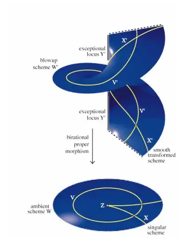

Here is another picture of the same thing with a local picture of the blow up of the disc, which you can find in this great paper.

Not a picture and not a complex manifold, but I hope this helps. Take the curve $y^2 = x^2 (1 + x)$ in $\mathbb{R}^2$. It has a singularity (self-intersection) at the origin. The blow up embeds the curve in $\mathbb{R}^3$ and detaches the curve at the singularity: think about it as picking up one branch and lifting it above the other so that they don't intersect anymore. We are "blowing up" the curve at the singularity.
