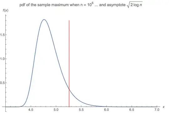

Not an answer, but a related comment that is too long for a comment box ...
This question made me curious to compare:
  • the pdf of the sample maximum (given a sample of size $n$ drawn on a N(0,1) parent), say $f(x;n):$
$$f(x) = \frac{2^{\frac{1}{2}-n} n e^{-\frac{x^2}{2}} \left(1+\text{erf}\left(\frac{x}{\sqrt{2}}\right)\right)^{n-1}}{\sqrt{\pi }}$$ where erf(.) denotes the error function, to
  • the asymptote proposed by the question $\sqrt{2 \log n}$
... when $n$ is very large (say $n$ = 1 million).
The diagram compares:
The distribution does not, in fact, converge to the asymptote in any meaningful manner, even when $n$ is very large, such as $n$ = 1 million or 100 million or even a billion.
wolfies
  • 5,244
  • Are you using the right logarithm? (I.e. base $e$ and not base 10?) – Chill2Macht Oct 01 '18 at 00:13
    Yes - $\sqrt{2 \log \left(10^6\right)}$ = 5.25 ... as shown in the diagram above (the red line). By contrast, with base 10, the same calculation would be equal to $2 \sqrt{3}$ which is approx 3.46. – wolfies Oct 01 '18 at 07:17
  • Using the large-$x$ asymptotics of the error function, I found that the maximum is attended at $\sqrt {2\log n} \left( {1 + \mathcal{O}\left( {\frac{1}{{\log n}}} \right)} \right)$, showing that the convergence is very slow. – Gary Nov 05 '20 at 10:47
