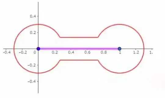

We use the contour: (consisted of upper segment: slightly above $[0,1]$, lower segment: slightly below $[0,1]$, circle of small radius enclosing $0$, and circle of small radius enclosing $1$, that looks like a dumbbell having knobs at $0$ and $1$, can someone edit this and include a picture of it please? In fact, this is also the same contour as in Ex VI, with different endpoints.)

Define the contour $C$ surrounding the two branch points $0$ and $1$ in the counterclockwise direction, composed of two small circular arcs and two straight lines along the real axis. Assume
\begin{align*} - \pi &\leq \arg z < \pi, \\ 0 &\leq \arg (1 - z) < 2 \pi \end{align*} image
\begin{align*} \oint_C f(z) \, dz &= \int_{1}^{0} e^{x \ln(x) + (1 - x) (\ln(1 - x) + 2 \pi i) + i \pi x} \, dx \\ &\quad + \int_{0}^{1} e^{x \ln(x) + (1 - x) \ln(1 - x) + i \pi x} \, dx \\ &= 2i \int_{0}^{1} x^x \cdot (1 - x)^{1 - x} \cdot \sin(\pi x) \, dx \\ &= 2i I \end{align*}
