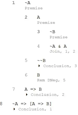

If sentence $A$ is true and $B$ is true then $A\implies B$ is true.
Yes. In mathematics and logic as widely applied, $A\implies B$ is equivalent to $\neg[A\land\neg B]$.
So, if $A$ is true and $B$ is true, then $\neg[A\land\neg B]$ and hence $A\implies B$ will also be true.
Does that mean if $A$ and $B$ are both true then there is a way to prove $B$ is true from $A$, always?
Yes. Here is a formal proof using a form of natural deduction:
The same for if $A$ is false can you get anything either True or false proved from this $A$?
Yes. Here is a formal proof:
That the above may seem counter-intuitive may stem from the fact that implication is often confused with temporal notions of causality. The statement, "If it is raining, then it is cloudy" does not mean that rain always causes cloudiness, or that cloudiness always cause rain. It means only that, at a given instant in time (usually the present), its is not the case that it is both raining and not cloudy.

  • Until students understand some of the most basic methods of proof (as in my first proof of $A \land B \implies (A\implies B)$ above), they will simply have to apply the definition $A\implies B\equiv \neg(A \land \neg B)$. – Dan Christensen Nov 07 '20 at 03:55
  • I've made you a most simple example, and you can't make it work? – Cornelius Nov 08 '20 at 09:57
  • @Cornelius As for your simple example, "What happens then?" is a bit ambiguous. You have, of course, $P\implies Q$. But that is not something that "happens." It is simply not the case that both P is true and Q is false. – Dan Christensen Nov 08 '20 at 18:04
  • So, if P is false, and Q is true, the outcome would be "you didn't run 100m under 10.05 => you have qualified for the olypmics" which is not true. So ⊥=> ⊤ is ⊥? – Cornelius Nov 13 '20 at 00:11
  • @Cornelius As I have proven above, if $P$ is false, then, for ANY logical proposition $Q$ (be it true or false), the implication $P \implies Q$ is always true. That doesn't, however, mean the $Q$ must be true. Neither does it mean that $Q$ must be false. – Dan Christensen Nov 14 '20 at 01:38
  • New versions of proofs posted 6 years later. – Dan Christensen Nov 14 '20 at 03:49
