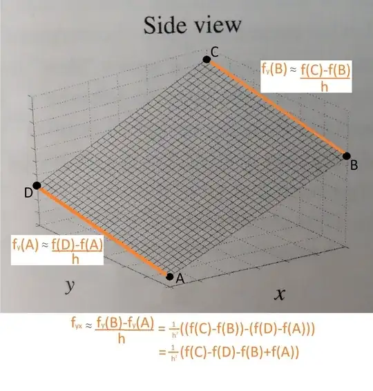

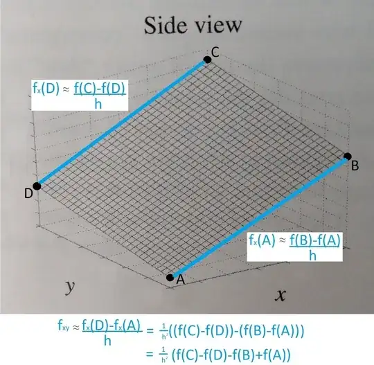

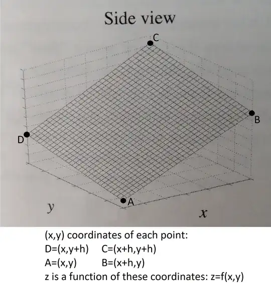

  • For consistency, I've used the idea from Ted Shifrin's comment and Rahul's answer/figure. I've included some colorized figures, which might help with the geometric interpretation for some individuals. general figure
fxy
fyx
fxy=fyx
Perhaps, a good way to think of the equality of mixed partial derivatives is like this: the change in slope (in the y-direction) of the changes in slope (in the x-direction) is the same as the change in slope (in the x-direction) of the changes in slope (in the y-direction). Either way, we're effectively finding the change in slope between the high point(C) and the low point (A), with consideration to the intervening points (B and D), for the particular function we're working with. Whether we go via the x-direction first or the y-direction first doesn't matter.

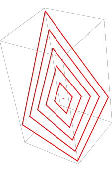

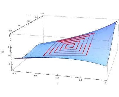

Example of a regular function (graph in blue) and the image of a square (in red) for different lengths (see Rahul's answer):
Same picture without the graph of $f$: the opposite segments become parallel when the step decreases. This is a geometric interpretation of Schwarz theorem.
