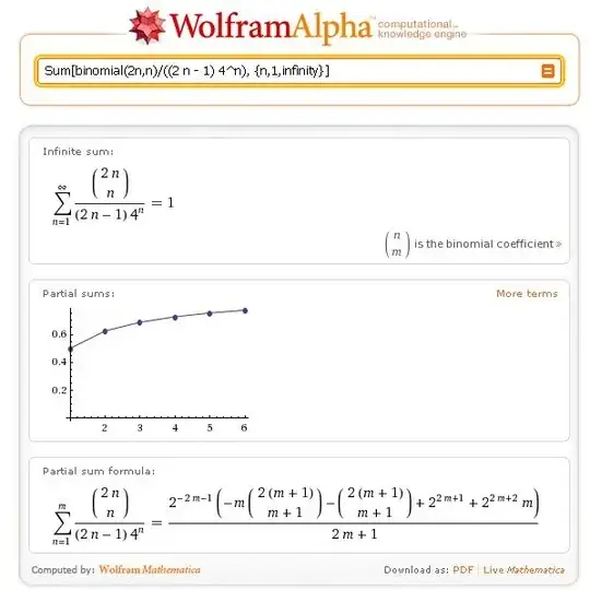

In fact the sum converges. You can find a closed form by massaging the formula that I posted on Hadamard products viz. $\rm\ (1-4x)^{-1/2} \;=\; \sum\ \binom{2n}{n}\ x^n\:.\ $ See also this post. Alternatively:
alt text
Bill Dubuque
