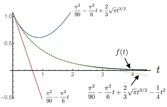

Further Notes Here is a plot of the function $f(t)$ given by the series, as well as the approximations from Marko Riedel's answer: enter image description here

This gives the following expansion in a neighborhood of zero: $$S(x) \sim \frac{\pi^4}{90} - \frac{\pi^2}{6} x^2 + \frac{2}{3}\sqrt{\pi} x^3 - \frac{1}{4} x^4.$$
Since the sum being asked for is actually $S(\sqrt{t})$ we obtain $$S(\sqrt{t}) \sim \frac{\pi^4}{90} - \frac{\pi^2}{6} t + \frac{2}{3}\sqrt{\pi} t\sqrt{t} - \frac{1}{4} t^2.$$
This answer matches the results from the earlier posts, which deserve the credit, with this contribution being enrichment only.

As noted in other answers here, $f''(t)=\sum e^{-n^2t}$, which is the Riemann sum for $\int_0^{\infty}e^{-x^2t}dx=\sqrt{\pi/4t}$. So $f(t)$ will be the integral of the integral of that, or $(2/3)\sqrt{\pi}t^{3/2}$, plus At+B.
