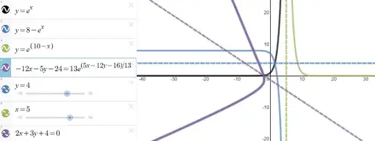

Use the reflection formula: $$\frac{x'-x}a=\frac{y'-y}b=\frac{-2(ax+by+c)}{a^2+b^2}\quad\text{for line }ax+by+c=0$$ Case A:
Line is $y-4=0$: $$\frac{x'-x}0=\frac{y'-y}1=\frac{-2(y-4)}{1}$$ where a convention is to take $0/0$ which is a result of the derivation. $$\implies x'=x,y'=8-y$$ So curve becomes: $$y'=8-e^{x'}\equiv y=8-e^x$$
Case B:
Line is $x-5=0$: $$\frac{x'-x}1=\frac{y'-y}0=\frac{-2(x-5)}{1}$$ where a convention is to take $0/0$ which is a result of the derivation. $$\implies x'=10-x,y'=y$$ So curve becomes: $$y'=e^{10-x'}\equiv y=e^{10-x}$$
Case C:
Let the line be $2x+3y+4=0$: $$\frac{x'-x}2=\frac{y'-y}3=\frac{-2(2x+3y+4)}{13}$$ $$\implies x'=\frac1{13}(5x-12y-16), y'=\frac1{13}(-12x-5y-24)$$ Or: $$x=\frac1{13}(5x'-12y'-16),y=\frac1{13}(-12x'-5y'-24)$$ So curve becomes: $$\large (-12x'-5y'-24)=13e^{(5x'-12y'-16)/13}\\\large \equiv -12x-5y-24=13e^{(5x-12y-16)/13}$$ enter image description here

  • The last case in your answer is incorrect. Note that the purple graph is not symmetrical to the black graph along the purple line. I gave my answer which I believe is correct. – Arbuja Jun 23 '16 at 19:10
  • @Arbuja The picture looks correct. – Théophile Sep 01 '22 at 14:36
