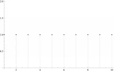

For example, if we sum $1$ number ($1$-$10$), the distribution looks like
$\hspace{3cm}$enter image description here

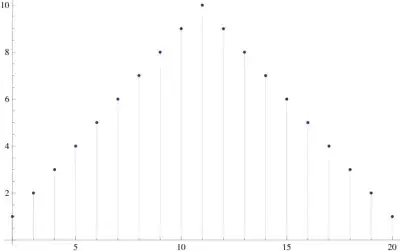

If we sum $2$ numbers ($1$-$10$), the distribution looks like

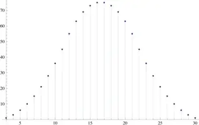

If we sum $3$ numbers ($1$-$10$), the distribution starts to looks like a normal distribution

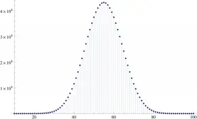

If we sum $10$ numbers ($1$-$10$), the distribution looks even more like a normal distribution

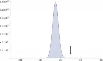

Now lets look at the sum of $100$ numbers ($1$-$10$)
The number of ways for $100$ numbers ($1$-$10$) to sum to $700$, which was computed in this answer, is pointed to by the arrow. Note that the range of the sum is $9n$ where $n$ is how many numbers are added; however, the standard deviation is $\sqrt{8.25n}$. Thus, the relative spread gets smaller; that is, the distribution becomes narrower about the mean as $n$ get bigger.
The maximum number of ways to sum to $T$ is at the mean of the distribution; that is, at $T=550$, where the number of ways is $$ 13868117806391314648666325510838589167047653141664\\4888545033078503482282975641730091720919340564340 $$ which is approximately $1.3868117806391314649\times10^{98}$.
