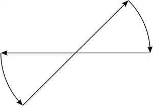

Since $e^{-z^2}$ is entire, $$ \int_\gamma e^{-z^2}\,\mathrm{d}z=0\tag{2} $$ over any closed contour $\gamma$ ; for example, $[R,-R]\cup-Re^{i\pi[0,1/4]}\cup e^{i\pi/4}[-R,R]\cup Re^{i\pi[1/4,0]}$:
$\hspace{5cm}$
As $R\to\infty$, the integral over the diagonal path, where $z=\frac{1+i}2x$ and $-z^2=-ix^2$, is equal to $$ \int_{-\infty}^\infty e^{-ix^2}\tfrac{1+i}{\sqrt2}\,\mathrm{d}x=\tfrac{1+i}{\sqrt2}\int_{-\infty}^\infty e^{-ix^2}\,\mathrm{d}x\tag{3} $$ and the integral over the horizontal path, where $z=x$, is $$ -\int_{-\infty}^\infty e^{-x^2}\,\mathrm{d}x\tag{4} $$ As shown below, the integral over the curved segments vanish as $R\to\infty$, we get from $(2)$ that the sum of the integrals in $(3)$ and $(4)$ is $0$. That is, $$ \begin{align} \int_{-\infty}^\infty e^{-ix^2}\,\mathrm{d}x &=\tfrac{1-i}{\sqrt2}\int_{-\infty}^\infty e^{-x^2}\,\mathrm{d}x\\ &=(1-i)\sqrt{\frac\pi2}\tag{5} \end{align} $$
Curved Contours
On the right hand curve, $z=Re^{it}$ for $t\in[0,\pi/4]$. Therefore, $$ \begin{align} \left|\,\int_\gamma e^{-z^2}\,\mathrm{d}z\,\right| &=\left|\,\int_0^{\pi/4}e^{-R^2e^{2it}}iRe^{it}\,\mathrm{d}t\,\right|\\ &\le\int_0^{\pi/4}e^{-R^2\cos(2t)}R\,\mathrm{d}t\\ &\le\int_0^{\pi/4}e^{-R^2(1-4t/\pi)}R\,\mathrm{d}t\\ &=\frac{\pi}{4R}\int_0^{R^2}e^{-u}\,\mathrm{d}u\\ &\le\frac{\pi}{4R} \end{align} $$ The left hand contour is similar.
