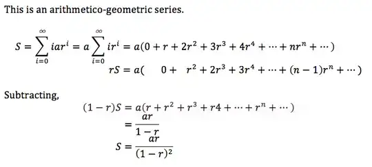

Here's an alternative derivation.
$$\frac{a}{(1-r)^2}=\sum_{i=1}^\infty iar^{i-1}\iff \frac{a}{(1-r)^2}=\frac{1}{r}\sum_{i=1}^\infty iar^i$$ I guess for some reason this step was omitted but both answers are correct except the first one doesn't answer the question.
